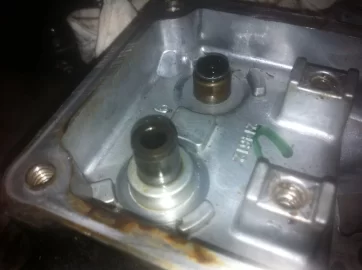

I had the same issue with my 25hp B&S. Looking around I found that the sleeves in the head that the pushrods run through were walking out of the head. From reading it seems that any sort of debris in the cooling fins will overheat the heads and make the sleeves walk out. Easiest fix was to remove the heads, set the sleeves back where they belong and then dimple the top of the head so the sleeve can't move. Been over a year since I had to adjust them the last time.
Going only by your description, I’ve not seen this engine, I’d be thinking about running a hand reamer thru that valve guide after dimpling.
Here's what the head looks like under the valve cover with the guides where they shouldn't be. All I did was dimple the aluminum around the guide (thanks for that I, my brain wasn't working this morning and sleeve was what I came up with lol) the guide sits just low enough to dimple it without interfering with the guide itself.
