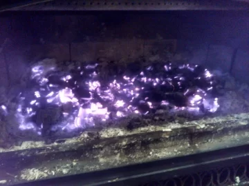

Here is my coals from all maple wood.
  • [Hearth.com] What do your coals look Like
Reactions: corey21
It was a load I started when I got home 4pm. This maple doesnt burn for a long time like oak or hickory.
Its just a little bit too much moisture as the wood was just cut last May and split and stacked.We had a really dry summer. (extreme drought)
I am thinking its not hard maple but its not bad. It will pop a little.
So it was maybe 3/4 full stove load. This pic is at 5.5 hours as I let it burn at a higher rate for a while to take the chill off the house tonight.
I didnt take the pic to show coals of a all night burn. But at the time I had raked them some and was letting them burn down some.

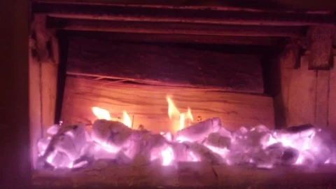

Here I raked them forward and put a big piece in the back bottom and another piece on top of it.

Here I load the second row of two more splits.

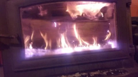

The third and final row I just took a 1 wedge split and propped to up on its thin edge down on the coals.

And she takes off.........................
Definitely the propped up gets some air flow.
