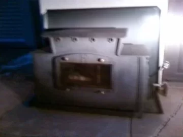

Hi,
There is a stove for sale on the Albuquerque Craigslist that the seller says is an Englander. However, he does not know what model it is, nor the year. It looks like an insert to me. Do any of you have a clue what this stove is? Thanks.

the unit is a "28-c" side loading hearth model , its pre-epa, that series (as well as the 26-c (which had just 3 heat tubes in the keystone top)) were produced from about 1980 through about 1988. the unit is virtually all 1/4 inch plate steel , and will probably be around well past when the sun finally dies out. i guess you would classify it as a "smoke dragon" as its not catalytic or non-cat reburn , be advised if you go to pick it up , better bring the football team, she be quite heavy
You would think that a guy asking $800 for something would take a few extra seconds to take a better picture. A little bit of light and getting it in focus might have helped.
I don't know much about these old "Classic Stoves" ;OP but I think he's nuts thinking he's going to get $800 for it.

actually sly , thats likely what the uit sold new for , or within a couple hundred bucks. its not worth half that IMHO unless its practically new, would be better to look for a 30 on clearance for about the same amount and get a modern epa unit with all the bells and whistles
Only reason I didn't buy it at J.E. Rice Hardware in 1985 was the side loading door.
