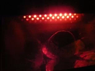

Most of the time my Oslo's front damper control is 75% or more closed. For the coldest nights, I save my large splits of Hickory and Oak. I cut my wood to 20" and
often try and pack the largest piece in back or save an xtra large half round/slab on top. Wood species is key..... a well packed firebox with Hickory at 10 pm
scores a chunky hot bed of coals at 7am. I am also very picky about seasoning my wood and knowing my species. 1/2 my supply is already 12-24 months old, I can't express the fact more that "a mix of med/large well seasoned dry splits of wood"
are the key to getting your Oslo up to 600-650 quickly before knocking the draft control down for a 500-550 overnight fire. (I'm talking peak here after your secondaries even out not a full blown 8hr 500 degree fire)
20 minutes into secondary burn
Wood:Shagbark Hickory
Stovetop temp:600
Draft control 75% closed
