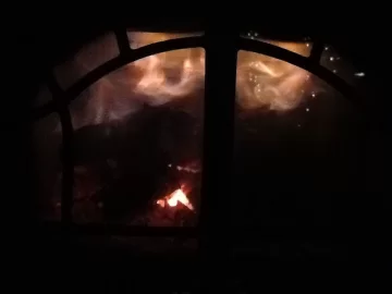

Pic taken 1 1/2 hours after first flames. Sorry if quality isn't that good taken with my Ipad.

What happens if you just leave the primary air open a crack instead of the start-up?
And, does the glass stay clean?
Glass looks great, either way, no difference. With primary air just cracked I have issues losing reburn, I was always having issues "just turning it down and letting it coast" as a lot of people on here put it. Now it seems that with the start up air cracked the stove is easier to operate.
