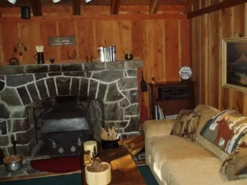

Fireplace is big and arched, 48 inches wide and 36 inches high in the middle. Made of big stones with an irregular face that made inserts difficult. The stone hearth extends out 24 inches. I hope that helps.
Here's a picture of fireplace, sorry it's crooked and off-center.

I do not understand what is wrong with putting a top exhaust stove in that fireplace. I could drive my Suburban into that thing. That thing would hold a top vented Jotul Firelight.

Did I read something wrong? Looks like he said that fireplace is:
"48 inches wide and 36 inches high in the middle"
Any stove on the planet would fit it. Look at his picture. That little black spot on the bottom of the fireplace is one of the big old Timberline stoves!

That is a 1974 Schrader in the huge fireplace now, by the way. This is my first woodstove, and the cabin is far enough away from Portland, Oregon that nobody wants to go up there to see the fireplace in person, so I didn't realize I could fit a top-vent stove in there too. I guess I will look at all the rest now, including Englander and Jotul!
