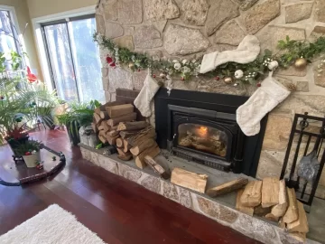

Stacking at least 4 days worth by the stove, and keeping that supply by the stove at all times, always burning the oldest and driest, would do a lot. We keep a face cord by the stove, and it is much drier after 2-3 days than when we brought it in. After 4 days it's real dry. This is not fresh split, and has usually been stacked for a year or more, but you can tell the difference. A piece of fresh wood by the stove will usually be dry enough to burn well in 4-5 days, depending on species. A friend on mine is short on wood this year and I told him the same thing, stack it by the stove.

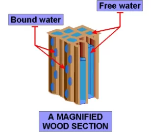

Love this!The energy penalty from burning wet wood is not very large, so long as you can get the wood to ignite, at least on its outer layers, rather quickly. Cellulose is about 16 MJ/kg of energy when you burn it cleanly. Water is 2.5 MJ/kg to vaporize. A 10% increase in moisture content is thus only about 0.25 MJ penalty, or around 1.5% of the heat you'll get out of the kg of bone dry wood. But, if the wood won't ignite, then you'll lose a much larger fraction than that as heat up the chimney while you've got the door and or damper wide open. If it smolders for a long time with a low stove temperature, you'll lose a lot more than 1.5% energy as unburned gases out the top of the stack (and risk creosote buildup). Getting wood to ignite quickly and not smolder in a cold stove is where a hot start with dry kindling, the wood species (as mentioned by other posters), as well as the hot reload, and probably strong airflow, all combine. You can get most of the heat out of the wood still, but you will need to modify your firecraft and may need to do frequent, small reloads on big beds of hot coals -- the ideal of running long combustion cycles with full reloads and low air for sure will not fly with very wet wood.
