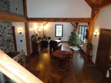

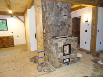

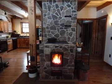

I uploaded a few pics. The house in a pretty open concept: One bedroom on the 1st floor along with a kitchen and living room, one big bedroom on the second floor and a loft. All areas of the house stay mostly uniform with respect to temperature, maybe a 2 degree difference at most. I have a PE Summit in the basement as well. I put about 2 cords through the heater and 2 through the summit. The reason I divide the heating load is because if I fire the heater in the morning without being around to close the damper (about 2 hours after the fire is lit), heat is lost up the flue after the fire is out. The heater can easily carry the load for the 1st and second floor, but during the colder months I'd have to fire it 2X per day. So by putting a fire in the stove and the heater, I am able to keep all floors, including the basement, about 70 degrees. If I am home in the AM, I prefer to fire the heater in the AM and PM. It provides an even heat that is most like hot water radiators. Coming in from the cold and backing up against the heater is an experience that is worth having. The heater is never too hot to touch. The heater has a cook top, which gets hot enough to make soup, but in all honesty doesn't get nearly as hot as the Summit downstairs. That being said, the oven is far more versatile than I was expecting. I can throw steaks right on the bricks and have them perfectly cooked, with a slightly smokey flavor, in a few minutes. Bacon wrapped scallops in the oven with a side of asparagus is simply the best meal I have ever had. To be able to cook dinner while heating the house just seems right. Once the heating season starts, we cook dinner every night in the heater. Just an FYI, I put a fire in the heater every evening from November through early April. It is far more efficient if fired daily.
[Hearth.com] What is a Masonry Heater [Hearth.com] What is a Masonry Heater [Hearth.com] What is a Masonry Heater
Thanks, I hear so little about real world use - you know the day-to-day stuff. Wow your house looks really nice. It sounds like your masonry heater is working well for your needs.
Thanks! I should mention that the house, excluding the basement is about 1600 square foot. I don't think a heater would work well if the house was more traditional and had many rooms in segmented hallways. During the design process, Alex needed the layout for the house to put together a heater that would meet our needs. I have to give him credit, when either I or the mason had questions along the way, he was always available for a phone consultation. In fact, he wanted to see pics of the build along the way to make sure that we were staying true to his design.
