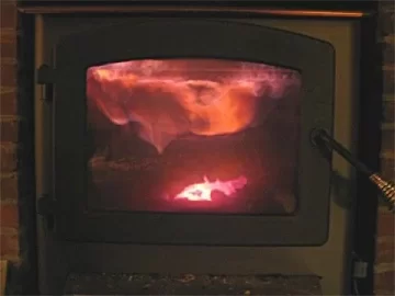

And sometimes just for grins ya can go thermonuclear.
  • [Hearth.com] What is a "secondary burn"?

You call that a secondary burn.... check this one out. Its a bit dark, but he'll get the idea.

Yes, that's certainly a nice secondary burn also. The only point I wanted to make was that it is NOT just the nuclear event that was shown above. Maybe I'm wrong but it seems too many expect flames "coming out of the secondaries" when that's not what's happening at all.
