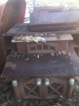

Hello All,
I am new in the world of wood Burning Stoves but since I've bought my 1800 s.f house built in the 1900, I wanted to keep some vintage intakt and keep the future heat pump from stressing out too much and what better way. A buddy is gonna give me this stove but neither of us know what it is and I wanted to get so more seasoned opinions on how effect it would be in keeping my house cozzy and, who the manufacturer is, if it is worth my time cleaning up, how to clean, if it can be cleaned an a plethora of other question but i'll be happy with answers to a few of these. I have attached a piture.
  • [Hearth.com] What is this?

Now, with that said, sometimes "vintage" doesn't always make it the safest. If your bud doesn't know the history of the stove - the previous operation (how hot/how many times) are they any cracks that are visible OR invisible, the CAT (catalytic converter [if it has]) or secondary air tubes' condition, etc. I would STRONGLY suggest buying a new stove. Do you want to wake up burnt to a crisp one morning? Your Wife? Kids? All the above??

A couple of pics of the inside would tell us more....
Some of the newer stoves have that "vintage" look.
Pacific Energy Alderlea
Drolet Jurresien.
(broken link removed to http://www.drolet.ca/en/products/wood/jurassien-epa)
It's an old timer with a clearstory view. No idea who made the stove or whether it's worth resurrection. But if you are willing, go at it with a wire brush, hand held, and a wire wheel on a drill to clean off as much rust as possible. Paint it with a good high-temp paint like Stove-Brite and enjoy the stove. Let us know how it works out for you.

Lots more "science" involved than I thought would be. It may have a secondary combustion chamber as there are some spaces that I cant tell exactly where they go. I noticed that this one has flanges too that suggest it inserts into a wall and the back half is concealed. Does that sound right? Their are also electric fans for the sides.
Thanks again for the feedback and i'll get some detailed pics up of the inside and let you know if I find and casting numbers or what not.

dieskyverjosh, since you have family in the metal-fab business, maybe consider modding the insert to burn clean by adding secondary combustion to it.

Wear a good dust mask and eye protection when cleaning it up. And take some pictures of the insides so we can tell more.

I could be wrong,, but it looks like a defiance insert..... I think they called it a master's choice. Hiram would know for sure.
