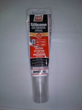

I replaced my door gasket yesterday. I used the red silicone sealer that SBI sent with the gasket. Under the old gasket was a bead of red silicone; I believe it is the same as what they sent me. It came of very easy with a wire brush attached to an angle grinder. Got it clean down to the 'shine'. It was much easier than the cement type sealer on a previous stove door gasket that I replaced.
