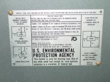

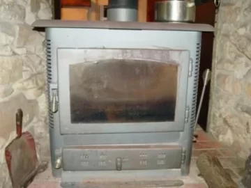

Can you post some pictures of the stove, and describe your method for initiating a coal fire? Perhaps that's a good place to start from.
Thank you all for taking my whining and turning it into something productive. The coal ranges in size from the size of a grape up to the size of a small lemon. I believe it is anthracite coal, when I run a Google image search the images that come up look exactly like what I have. Most likely, I am not doing something correct. The stove draws very well (the stack runs up through the center of the house).
This is how *try to* build a coal fire. The damper is open all the way, and often I have the ash pan door cracked open during all of these steps:

  • [Hearth.com] What I've learned about coal
