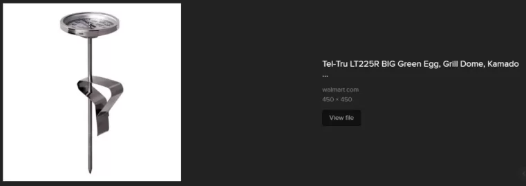

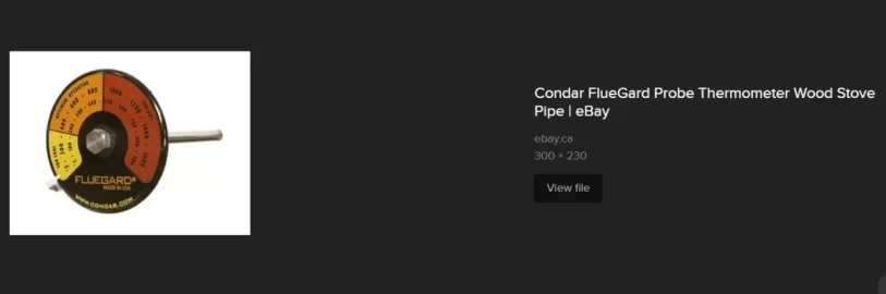

Forget about the stove top temp get a pipe thermometer. If you have single wall a simple magnetic one is fine. Double wall needs a probe. Run your stove according to that. Run it up into the upper part of the safe burn range then start shutting back. Keep it on the lower end of that range untill it is charcoal. Then it can drop.

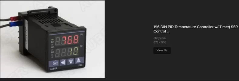

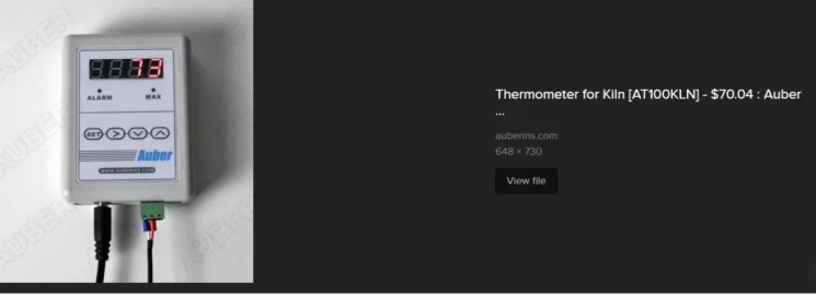

Ok, so one can tune the stove into an optimal burning condition. However, how do you know that the stove will stay at this optimal condition for hours? There is no feedback loop and we cannot stay at the stove to stare at the thermometer all the time, right?
I guess a good stove will correct itself so it stays in the "zone"? But what if there is a sudden environment change, like gusty wind changing the draft condition, log shifting in the fire and somehow block or unblock air intake, or some condition that I haven't consider. Will that "kick" the stove out of the "zone"?
It is not like I can do anything with my stove though. :(
Generally once you get secondarys going and get it shut back to the point that works for your setup you don't have to touch it again untill you reload

The flue temperature is still an approximation, just like the stove top, what you really want is the temperature inside the combustion chamber at the tube (for a non-cat), am I correct?
No what is important is keeping the chimney above the condensation point untill you are done burning off the volatile compounds in the wood that create creosote. I am sure you could fine tune things a bit better with internal temps like you said but it is not nessecary
You mean the temp at the top of the chimney? I think this is feasible to have a temperature sensor up top and transmit it down for a reading. More feasible than to get the temp at the tube which is not only inaccessible but also incredibly hot.
A surface thermometer on a single-wall pipe is somewhat of an approximation but better than the stovetop which has the lag time of getting a lot more mass up to temperature. It's much less of an approximation with a probe thermometer.
You are really over thinking this
