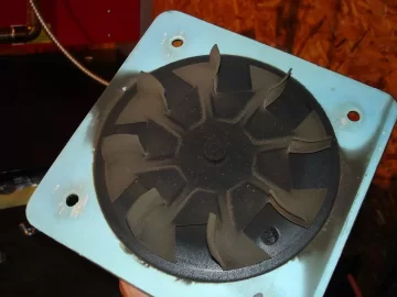

Ok, so I opened up all the air controls (shutters) and inspected the primary and secondary air passages......all clear. I also removed the exhaust fan and took some pics of that, messed with the fan blade depth relitive to the suction hole, don't ask.
Air shutters, I peered in behind with a bore light. All clear, and was able to see all secondary refractory holes (air outlets).
[Hearth.com] What kind of stack temps do you have at full output?
Fan "suction hole" this soot is sandy and black
Fan
