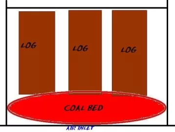

This is what i do.
#1 Cut the log a bit shorter as so to have room for the coal bed in front and put the logs towards the back. 2-3 splits is all thats is needed above 25° and highs back up to 50°-60°

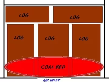

#2 When it gets colder than 25° at night and highs only 30° i will bring the coal bed to the front as before but put logs in the back and pull the front logs forward.
#3 Colder yet i can go 2 - 3 high in formation #2
