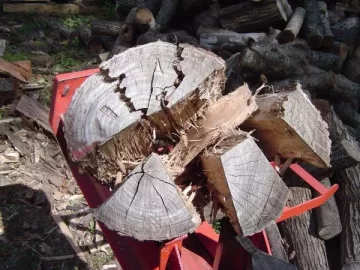

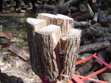

I have been splitting off and on this morning and found a piece of wood in my pile I bought off a local farmer. It seems the ole Huskee has found its match. The below pictures are the wood I don't know what it is.
Could someone tell me what and why its so tough to split?

As I have said to many others, it is really hard to tell species let alone genus from a small round with no leaves/nodes or other identifiers, but as a guess and looking at the bark and all those strings I would say some kind of elm. Hey, it IS split, ya just gotta cut all those strings apart.LOL :exclaim: Gotta love that elm, if that's what this is...not. %-P I just got done splitting a bunch of elm and If you add a 6" round about 2-2.5 " to the end on the bottom plate of the splitter, the ram will cut most of those strings.
Id say elm!
My elm will do that sometime...just flip it around, try and align the wedge with the other splits and re-split it from the other side. Yeah it look ugly but still burns well.
Elm! Best way I found to split that crap is to work around the edges, If you go right for the center you get a splintered mess.
I got it split and my huskee is still worth every penny. But it did take me at least 5 mins and changing from one end to another and putting another piece behind it and?????????????????? I would take a pic of it but its in about 10 pieces and stringy as hell.

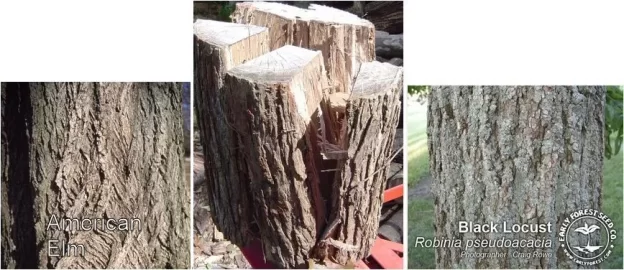

Black Locust. Split when green you'll have much better luck.
Yes sir, I agree....witcha got yourself there is some locust. And that stuff is pain to split and will smell like dog sh!t when burnt. And yes Jags, that splitter will split just about anything, that wood looks split to me just needs pulled apart.... >:-( Just remember Jags you can run but you cant hide...you could even ride that scooter around thats in your avatar but you still cant hide!
I dunno...when I first read the title, I figured it was either elm or a chunk of steel wedged in a tree...then saw that bark and all those strings...I said 'yep...elm..you're probably wishing it was a chunk of steel...easier to split" I compiled a pic...American Elm, the mystery wood, and Black Locust...
See what you think. Also curious, I've never known Locust to smell bad...at least none of the species around here. But elm, now that will smell like good ripe cat pee...especially a freshly split chunk on a hot day!

Locust does not really smell bad when your splitting or cutting like elm. It smells bad when it is burned.
