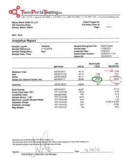

Riddle Master Morgon said:
Pellets are no fire wood, old rules dont apply...
Well, one rule does apply. Moisture in firewood kills its BTU output and that also applies to wood pellets. The higher the moisture content the lower its BTU's will be. If you look at some of the TwinPorts test sheets you will notice they usually provide the BTU content at its recieved moisture(red hilight) and also corrected value(green hilight) at 0% moisture. 0% moisture is much higher.
We all do what we need to do to get by. If your storing them outside try to keep them as dry as possible by keeping them up off the ground and wrapped tight. I'd also add some extra cover over them.
On humidity, The effect I see is pellets could absorb more moisture than if kept in a dry location.
