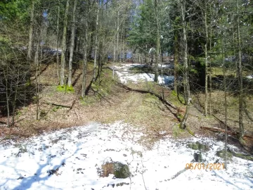

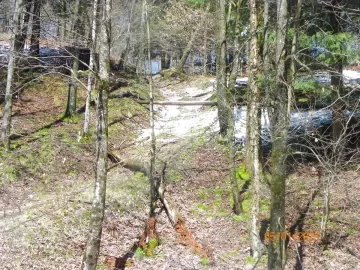

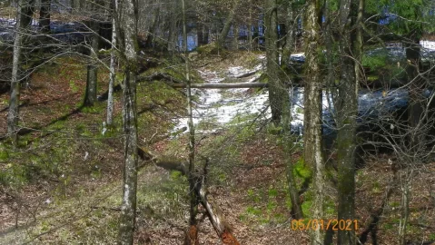

This is a trail that I'm thinking about opening up, what do you think the grade is percentage wise?
I'm not worried about coming down but I'm wondering about heading up it with a load of wood or the splitter behind the Rhino or Kubota.
[Hearth.com] What Percent Grade is This Hill [Hearth.com] What Percent Grade is This Hill [Hearth.com] What Percent Grade is This Hill

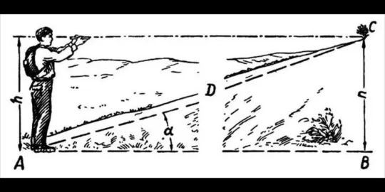

Look straight ahead
pace off to that location (x)
Height to your eyes = 5ft or so (y)
Divide y/x=slope percent
Fyi, 10% is about 6deg. 20 is 12deg etc.

I find pics of hills do no justice since depth perception isnt realized, time to get the measuring tape out and like Sawset said, measure here out, or go hillbilly and just do a full send with the rhino a few times and get a feeling how the empty machine handles the slope.

Look straight ahead
