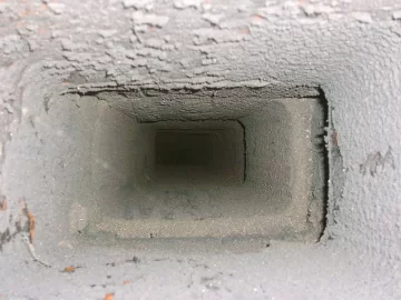

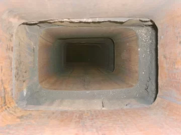

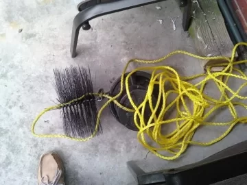

well no one had a 7x11 in stock but they did have an 8x12 at HD so i picked it up and snipped off about 1/4-1/2 inch all the way around it. didnt waste the $ on the flex rods as the damn brush was expensive enough. I picked up 50ft of rope, tied 30lbs of weights to it, tied the brush to it and down the 20ft chimney it went. i think it did a real nice job scrubbing the chimney but my arms are tired from pulling it up, then dropping it down, then pulling it up, then dropping it down haha. liner should be here soon...i hope!
here's a before and after shot. I guess my chimney was lined w terra cotta after all! it looked like cinder block before i scrubbed it. here's a pic of the rig i used too.

Very cleverly done.
