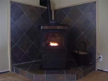

here's mine for a p43
length, depth and width are all 48"
front sides are 30", and front is 25"

41 x41 would suffice, but yo may need to go larger if DV thru a wall and it needs to be pulled out in order to avoid a stud w/ the vent..

Man, that's a nice job! I can't do 48" on one side though. Did you overkill, just to be safe or required? What's the safe minimum?

i built it to fit the room knowing ahead of time it would be plenty for the stove clearances....did it before the wood floors went in...took about a day
