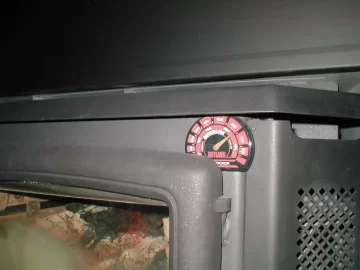

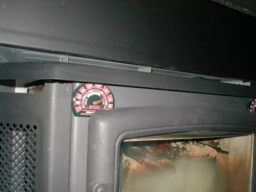

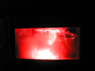

Pictures didn't turn out so well. This is after about 2-1/2 hrs. secondary burn going, and shots of the thermos in each corner.
Fire that puppy up with a few LARGE splits and rest mediums. Get her flaming open till 500-500 then shut the air down, she will climb to 650-700 on her own then enjoy.
If you use smaller & medium splits, cut the air back at 400-450 and she will still climb up to the hi temps.
Become one with your stove and you'll get a good feel for it.

Hogwildz said:
Down around 400 or so, your flirting with creosote buildup and won't be getting a couple hour secondary burn the way it should be, if any at all. These temps are taken from both front upper face corners just above the door corners.
Agree with the entire post, but quoted this as most important.
