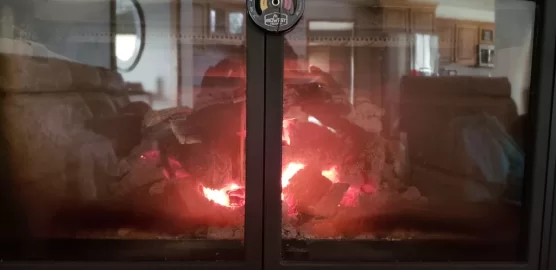

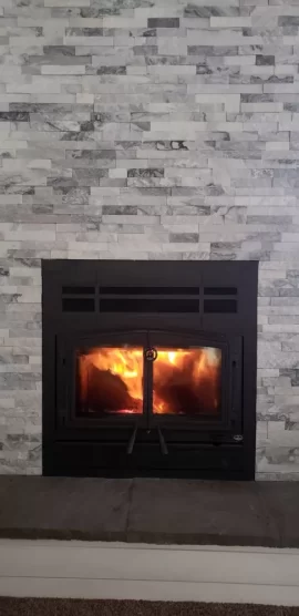

Hi guys, I have a osburn Stratford zero clearance wood burner. My question is what temps should my stove be at? Since I cant put a thermometer on the pipe. Can I put it on the door? Would the same ranges for a pipe thermometer work for the door temps? Obviously I'm a newbie, so any help is greatly appreciated

Can you remove the faceplate and put a thermometer at the base of the stove pipe? That's where I monitor temp on my ZC (Quad 7100).
That's a spot where lots of ZC owners here monitor their temps. I use a magnetic thermometer and it holds there fine. I've read where others had to wire theirs on after the heat got to their magnet, so while you're at it you might as well do that too.

Looks like you have a blower too. That's where your real heat will come from.

Put it about 6" in front of the stove pipe on the firebox top.
Position it so that it's visible through the vent slot. Take reading with the blower off for 5-10 minutes.

Seems cool. Is that current temp at coaling stage with the blower off?
