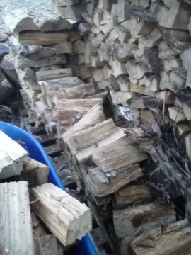

Well, I spent time this weekend moving my wood from the drying stacks to my 'immediate burn' pile -aka wood shed without a shed (tarp covering whole 4 cords).
Anyway - the piles have been stacked two splits deep along the side of my property for 3 years now. One pile was maple, black birch, and some misc wood. Other pile was mostly oak. I had not covered the wood any time during the drying time and there are trees above that provide summer shade and fall leaves... Each fall I tried to remove any leaves that were on top of the piles.
What I found as I pulled the piles apart is that the top few layers of wood have started to rot. There is composted leaves in there that have gone to dirt (good for garden, not so much for wood pile). The ends of the wood inside the stack have a fair amount of fungal growth as well. The wood itself does, however, appear to have dried fairly well though. Sorry, moisture meter broke years ago. Bark is falling off almost all pieces which I find unusual for my oak drying. Wood (that isn't going punky) is solid and crack when struck though. It is just the top 3-4 splits that have significant problems.
So my working theory is that the damage is due to not drying quickly in the middle of the stack and the leaves composting on top. A couple years ago I started top-covering my piles with a stapled tarp. I pulled one of those back and found that a squirrel had a nest in there, but it was all VERY dry and I didn't see any issues inside between splits.
I am thinking that with my two-split stacks (done such due to limited space to stacks that have to be stacked tall) it is better to put that tarp on the top from the beginning. I imagine that in other situations other solutions may work better, but thought I'd share this for anyone who may be debating.
My guess is that the leaves absorb rain/snow moisture and act like a "wet blanket" on the top of the stack, wood that never gets dry rots.

I think that in southern New England, you have to top cover. I've had single row stacks of oak grow fungus on them from the top row down to the bottom despite being stacked 15 feet from the house on a north south axis in a 1 acre yard with no trees on it at all. And I'm talking about a yard on top of a 200' high hill 1/4 mile off the Thames River and wide open with a power line ROW corridor running across it.....it's windy as hell back there so air circulation isn't the problem. It's just too damp in summer!

I've become a top-cover convert. I recently covered all of my wood. One year's worth with metal roofing, and the other 3 year's worth with plastic. I don't have any more roofing pieces, when I get more I'll use it instead of the plastic. When I was cutting wood and using it in a year or so I didn't notice a big difference leaving it uncovered. Now that I'm further ahead I'm afraid it will rot, or at least get punky, before I use it. I'm eager to see this coming winter if I notice a difference in the wood burning that has been top-covered.

I said it before here several times, I have rot in my stacks with red oak and soft maple if not covered in about 3 years just like slow 1. Ash, locust, and black cherry seem to hold up pretty well even though top covering is ideal I think for all wood by the second year. I have a small wood shed(converted from a dog pen) where I had some pin oak that never seen a drop of rain in 5 years until I burned some this past winter. Talking about some pretty wood that burned excellent, so I firmly believe in a wood shed or a airy barn as the best wood storage situation.

Slow1, you may or may not have saw a post I made about burning wood that has not been covered. The gist of the matter is that I experimented because it had been many, many years since we left any wood uncovered. The result was not good to say the least and that won't happen again.
We do leave our stacks uncovered through the first summer and fall but then top cover.
I've seen this mentioned many times about leaf problems but fail to understand it. Maybe it is because we normally stack wood where it will get wind but I'm not really sure. The picture below tells a story.

As stated above, we don't top cover the first year but then do top cover usually around December 1. This means the wood stacks get one whole shot of leaf drop in the fall of the year. Yet, we've never done a thing about getting any leaves off the wood and have never had a problem with it at all.
For sure where you live, I would top cover as soon as the wood gets stacked. That should work for you.
I'm pretty well convinced that top covering is the way to go. I had read many folks who said it didn't matter - I'm thinking now that while there may be some places where it doesn't matter as much, just about everywhere can benefit some.
My reluctance to cover also came from a need to keep things looking very neat and trim. Now that I have the "tarp showercap" method going with brown tarps the covers don't stand out much at all. While I'd like to use sheet metal or other covers, I don't think they will be as appealing to non-burning folks who live nearby. My stacks are almost all visible from the street and attract enough attention as it is - the last thing I want is a complaint to the town for any reason.
