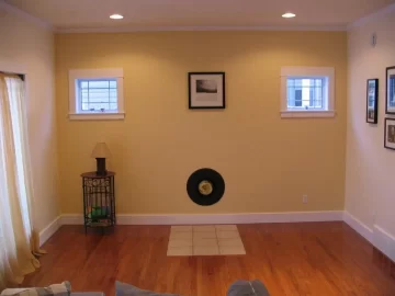

Hi,
We just moved into a new home (new to us but 4 years old) The builder put in a chimney (8" stainless insulated outside the house in an uninsulated chase). He was planning rear vent. The flue center is 20" off the floor (which seems low for every stove I've looked at). He inlayed tile on the floor but it's too small for any stove I can find. Looking for a Pacific energy or napolean. Any ideas? I would like to be able to put a plasma tv above whatever we do, so that would elimatinate a top vent stove. Here is a pic so you can see what I'm dealing with. Any ideas would be appreciated!! Room isn't that big 14'x20' 10' ceiling. House is 1750 sq ft. Would like a fireplace but not sure how big a mess that would make having one installed afer the flooring is done ect.

Very Nice Room
Very poor location for the chimney thimble...
Center is 20" off the floor- stove can be no taller that 8"
That will be a mighty small stove !
You might want to go to a fireplace store to see what can vent, at that hight.
I think a medium sized(2-2.5cu.ft)freestanding stove would be the easiest install,and the two brands you mentioned come as doublewall convection units....which I'd want in that room,'cause a radiant heating stove would burn you out of it.IMO.I agree on relocating that thimble as well,what was the original builder thinking he'd install there anyway?

A free standing stove is going to transmit the most heat per firebox size into the house. You will have to move the wall thimble, 20" is pretty low and you have to build a hearth pad so now that 20" is at least a few inches closer to the floor.
