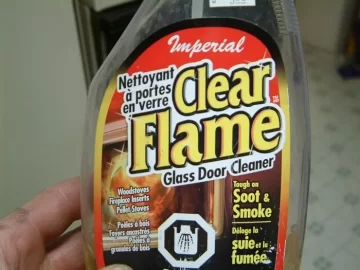

I'll have to try that Magic eraser, but this is second year on same bottle of this stuff, glass looks like new, smells a bit like sulfur, but no worse then wifes Farts, LOL... $10/Bottle over 2 years, prob keep using it, bought at any Home Hardware or probably Ace hardware.
  • [Hearth.com] what to clean glass with
