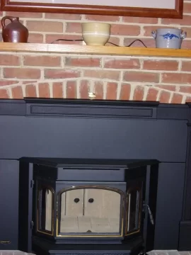

Thanks so much for all your responses! Just to clarify: the brick wall above the mantle is recessed about an inch compared to the brick wall below the mantle.
Attached is a pic so you can get a better idea what we have. My husband and I don't want to take a chance (at all!) on the clearance just for insurance purposes.
Using a heat shield is not even an option as far as I'm concerned. (Don't ask. . . .it's a fussy woman thing!) I (we) appreciate ALL your suggestions. Thanks.

How far out does the mantle stick out from the recessed brick? If it's only sitting on 1" of brick, how is it supported? Glue?

1. Yes, your mantle is noticably lower than ours.
2. But, unless the camera lens tricks the eye, (and it often does); it does look quite shallow. That makes a difference, even to Quadrafire spec. The best illustration of such was found in the Jotul 500 manual. (Yes, freestanding stove). The close "mantle" may actually be a "surround". BUT, they do show a much higher clearence requirement to start.
I didn't explain that very well, but on a similar note:
3. I know better than to go here, but...IF it is so shallow...a heat shield can be made to look hardly noticable.
OK, well, that said... I don't recommend burning it as is; especially not unattended. But maybe you can remove the existing mantle for this year, and then you can research/design and hit the ground running next summer.
BTW; it looks very good now.

Contact a mason and have him install a limestone,slate or stone mantel. You can buy a 12"X8' pc of limestone for about $100.00 that can be cut to fit your fireplace.
I wouldn't recommend adding brickwork to raise the existing wood mantel simply because it is very difficult to match bricks and mortar perfectly when you are trying to add to an existing pattern. Outside, a slight difference won't be noticeable, but if your brick color/texture, your mortar color/texture, or your points are off by even just a tiny bit it will be very noticeable indoors in the centerpiece of the room.
Since you seem dead set against a heat shield, I would go with stone - but with only 1" of support it may be a project to secure a stone mantel up there. You may be able to zip bricks out from the 2 rows under the mantel on each side and maybe one in the center and construct brick supports by mortaring bricks in to the open spots rotated 90. You'll still have to be careful to match the brick and mortar, but because the support bricks will be sticking out from the rest of the face and rotated 90 degrees they will pop anyway and a slight color difference probably won't be an issue.
A mason could figure something out no problem - but I wouldn't expect a mantel quality piece of stone for $100.00 (Thermal or chiseled face and edges)unless you decide to go to the wholesale yard and do the project yourself, and with only an inch of support it may be labor intensive to do it right. It is worth getting an opinion and a quote though - mud over an inch of brick for the entire width of a mantel = a lot of holding power, and a mason may look at it and tell you it is as simple as mudding the stone onto the existing support.
