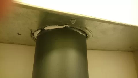

Hey guys
I can't seem to find the answer on the Internet so thought I'd ask here.
The stuff that was used to seal the gap between flue and register plate has dried out and is crumbling away. I need to reseal it and put some new stuff up.
What do I need to use? Is it fire cement or heat/fire resistant silicone sealant? Or are these the same thing?
I've found silicone sealant which seems the easiest option rated up to 300 degrees Celsius, will that be enough?
Do you have a picture? I'm not sure what is meant by a register plate.
The metal plate in the top of the stove opening

Ah, that would be a block-off plate over here. You can use a good quality furnace cement to fill the gap Silicones are not made for the hot temps that can be seen on the flue surface. Some will smoke quite a bit as they heat up. FWIW, this product claims it will set up like cement.
http://www.amazon.com/Rutland-600-Degree-Silicone-Cartridge-10-3-Ounce/dp/B001GP3AE6
What product were you thinking of trying?
As an alternative you could get some stove door rope gasket (about 20" of 1/2"?) and use it to fill the gap.

I was going to get this stuff
http://www.amazon.co.uk/VITCAS-Blac...F8&qid=1450774237&sr=8-1&keywords=fire+cement
Will this stuff be OK to use? I presume it is being fire cement. I want to double check before ordering it.
Yes, that looks like it would work.
