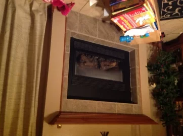

The more I look at the details, the less I think this will work. I currently have a very nice gas insert (a Mendota) in the fireplace. But I think the original fireplace was a pre-fab and I don't think this will work for the blaze king.
Thoughts?
Here is a pic of my current gas stove...

Well it was only used a few times one season. A person could probably talk him down a bit more, maybe 1500 and now you're talking essentially half price and it has hardly been used.
$1500 would be my top dollar, I hate buying used unless its a good deal, you would need a 6" flex liner, I couldnt open your link so not sure if thats what you linked to.
