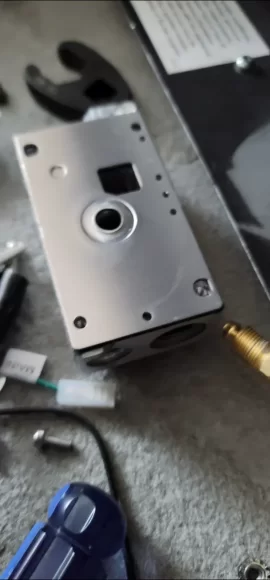

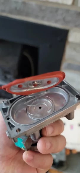

So I got the idea of using a handheld air blower to test. I.found out I was wrong. So using a small blower on the inlet with the pilot solenoid removed, no air goes through. It's like it's blocked. So I disassembled the unit and I find a diaphragm and such. With a blower on the inner again the air comes in the center of the block which mates up to the orange diaphragm. Is there something wrong with the diaphragm that it's not letting the air go through?

I was chasing my tail the entire time and I am more than a little embarassed. I made a faulty assumption and got inlet and outlet reversed. So no wonder everything tested OK electrically but didn't seem to permit flow. The outlet for the main burner is on the same side as the pilot outlet, and I made a major mistake there by assuming the Dexen valve would be configured the same way as the previous Honeywell vavle.
