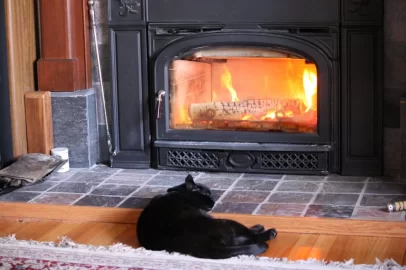

My wife always asks if it is time to add more splits to the fire. I tell her to ask the cat. In the picture below the old man, 17 years old, is saying the fire needs wood. If he is completely on the hearth he is letting us know the fire is out and he is getting the last of the heat from the tiles...

Love the picture. My dogs let me know if it's warm enough. LOL.

Nice pic.

Love it! I wish my "thermostat" was that obliging. Mine only sleeps on my favorite chair.:confused:
