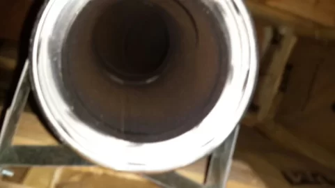

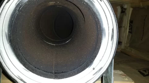

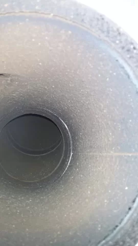

Hi everyone, I recently joined this site and have had one question answered that i was completely satisfied with. Now I have a huge question to ask. When should i clean my flue? I have had a stove for 2 years now and this is my second year burning. Some of the wood is seasoned and some is not due to poor stacking which will be fixed in the spring time. I am not a lazy person, so honest opinions are greatly appreciated and i will be cleaning my flue tomorrow if told to do so. I have burned around 2.5 cords of wood so far and i have noticed that the stove is burning at a lower temperature and the wood is taking much longer to burn than it usually does. I took some pictures to show how the flue looks on the inside around 6 feet from the actual stove itself. The stove is a heatilator ws22 with a 6" SS flue pipe. The buildup is coming out as cone shaped and not an even coating, I'm not sure if that is normal. Also, I have been reading that shiny buildup is very dangerous, and I have noticed that is starting to form as you can see in the pictures. The buildup is not 1/8" thick and i read that it should definitely be cleaned if there is 1/4" thick creosote in the pipes. Please check out the pictures and let me know if its time to clean it. I cleaned it once before from the top to the bottom and I will be cleaning from the bottom this time due to all of the snow on my roof. Thank you all in advance for the kind responses. The last thing I want to do is have an unnecessary fire in my flue and burn down my house and destroy my family's life. Thanks again for any input

well you can never clean to much to be safe. Personally i think you can go a few more weeks before you clean it but im going off experience with mine.

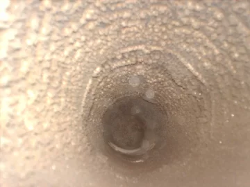

Heres a pic of mine when i clean it. Probably twice as thick as yours.
  • [Hearth.com] When to clean my stove......Fire hazard?

My answer would be to clean the chimney if you get 1/4 inch of creosote build up. Personally, I inspect and sweep monthly . . . but I am admittedly going overboard as I would never hear the end of it due to my line of work if I ever had a chimney fire.
Most folks here generally sweep once to twice a year. Once at the start of the burning season and once halfway through.
I don't think the build up looks all that bad honestly.
By the way, posting pics as thumbnails is often easier . . . especially for those folks who still may be on dial up. Even those of us on DSL,thumbnails just makes it easier to scroll through the post.
Finally, welcome to hearth.com.
The stage 3 at the seems bothers me. I would clean it sooner then latter.
I completely agree with the stage 3 buildup. I wonder why there is stage 3 without having too much creosote buildup everywhere? I also heard that stage 3 is a pain to get off. hopefully it comes off with just a poly brush. I have been using a poly brush because i was told that the ss brushes will damage my flue because it is SS itself. thanks for the info. Any other advise? I look forward to reading when other people clean their flues. thanks
That's not a lot of accumulation but I'd suggest brushing your flue anyhow, just to sleep better. :)

I'm thinking the cooler room air infiltrates the seems and condenses the flue gasses easier in those locations. Probably another good reason for double wall.
Though I have yet to see that happen in my single.
Wood is suspect.
Wood is suspect.
Hey, the flue is a double wall and i do agree with you that the air is probably getting in at the seems since thats the only place that I am getting the build up. The wood is most definitely the problem. I need better air circulation in my drying stacks. well, looks like I will be cleaning my fllue tomorrow. Hopefully i am able to get the stage 3 off with just the poly brush. I do not have any other means of removing it otherwise. thank you.
I didn't realize it was double wall. Yes get cleaning it.
If you take the pipes all apart I think you would be able to use a wire brush at the seems if need be?
Clean the chimney when you need to. You noticed a performance decrease so that sounds like you need to clean the chimney regardless of the buildup in there and which stage the creosote is. FWIW, the buildup doesn't look dangerous to me, but if burning is compromised than you need to fix the issue.
Matt
seams are getting some air leakage I suspect, the slight bit of cool air is condensing the soot there , not much of a leak but I suspect its there. not a "danger" thing requiring immediate correction, but when the season is over you may want to visit that area and see if you have a loose locking band or a misfitting section in need of being reseated.

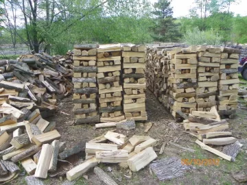

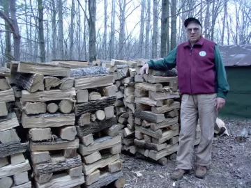

On the wood stacking, yes, air circulation is the big thing. Do not try to stack for a pretty stack though; you need to stack it a bit loose which will allow for the better air circulation. If you are stacking for 3 or 4 years ahead, then you can go for the tight and pretty stacks. Make sure you stack off the ground. We simply use saplings cut to 8' or 10' lengths. Lay down two and stack on them. Here is how we do it:
[Hearth.com] When to clean my stove......Fire hazard? [Hearth.com] When to clean my stove......Fire hazard?
You can see especially in the first picture the saplings that we lay down. The wood does not have to be high off the ground; just so the wood is not touching ground. We also stack to approximately 4 1/2' high. Stacking higher is possible but most folks who stack higher also have problems with the stacks falling over. I hate re-stacking. And for what it is worth, we typically split and stack in March/April. We top cover the wood usually around December 1 and then wait. We let Mother Nature do the drying and we try to stay 3 years or so ahead on our wood piles. The benefits of being that far ahead are numerous but the best parts is that the wood burns better and you'll burn less wood to get the needed heat. Well, it is also better than money in the bank as interest rates are not very high for sure and that wood pile won't even be taxed.
