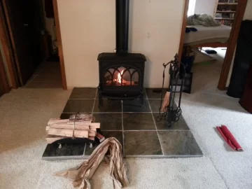

We now have the Jotul Castine installed. I have found the hard way that using dry wood is a huge help with turning down the air but I never know if I am turning it down at the proper time.
I usually wait until the secondaries are putting out flames at a fast pace and the flames are going around the baffle and then turn it down to 50%, 25% then 0%, each time waiting for the flames to get aggressive.
I think sometimes I have a wet piece of wood and after I turn it down to 0% then the secondaries go out and it just smolders even though it is up to temp. Should I be opening the air back up and letting it burn at 25% for the wet pieces I hit?
Should I be going by temperatures instead of what the fire is doing?
What is the purpose of closing the air slowly? I am more technical so if I understand it, I can usually use it better. Is it so the fire has time to adjust to the way it is burning and where it is getting it's air?
Am I losing a lot of heat by leaving the air open longer?
Is smoldering bad? It looks like it because the glass gets all kinds of soot on it. I have had good burns and bad burns and it is a learning experience.
