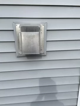

Ok I want to cut access to look at back of chase and fireplace. Where should I cut and how big does access need to be to inspect and clean anything off top of fireplace. Also need to remove silver lining from around firestop. When finished how do I insure lining is back in place? (Reference thread “can I paint”) this is new territory for me so need guidance. Wife freaking out about cutting hole in house!

Anywhere really in that area. Remove a strip of the siding then cut an inspection hole in the sheathing. Really not a big deal at all with vinyl siding
Not a big deal but before I cut how do I reseal hole Iam cutting to be watertight? Also is it important to keep that shiny foil insulation in place since iam going to have to cut through it and unwrap it from around the exiting firestop?
You don't cut through the siding. Just remove a section. Then a small hole to inspect. If there is insulation on the fireplace then you will cut a much larger hole
Yep I know not to cut through siding. I was speaking about the actual wood sheathing and the inside wall of chase insulation. Thanks for the help I will give it the old college try. I have removed siding before.
Remove a few courses of siding above the termination. Use a circular saw with the blade depth set to the thickness of the sheathing and cut out the area between the two studs in the middle of the chase. cut the piece neatly and save it to replace when done.
Remove the insulation as neatly as possible and inspect the fireplace and fix any issues.
You can attach plastic or metal banding across the inside of the studs to keep the insulation in place once it is replaced.
Replace the sheathing and use zip tape (rubber flashing) over the area where the sheathing was cut. Replace siding and then safely enjoy the use of your fireplace.

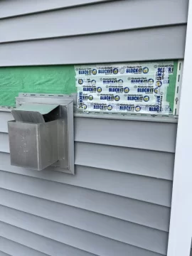

Ok I opened it up and found a few pieces of blown insulation a top of fire box dusty! Bigger thing sliver lining is sealed all aroun firestop with red stuff not gonna come off. Please advise soon. Gonna rain need to seal back up

It looks as if the foil faced paper is cut out for the clearance to the pipe. Looks like they sealed the pipe where it passes through the firestop also.
Without measuring everything myself to verify, it does appear that you have the proper clearances.
How do I repair that foil to close it up is it important ? Doesn’t it protect insulation? Help gonna rain soon
The foils primary purpose is to keep the insulation in place. It is also a vapor barrier but you should not have any problems with that small of an area if a small piece is left out.(the foil faced paper, not the insulation. The insulation needs to be put back)
Ok I put some foil tape I had on back side so insulation would not fall through. Hope that was ok. I am a complete novice at this. Can believe I cut a hole in my house!
