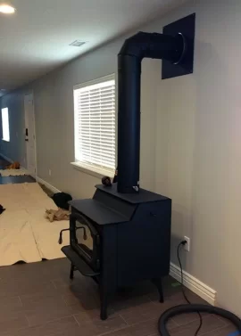

Thinking something like this for main level. (Just a random google pic.)

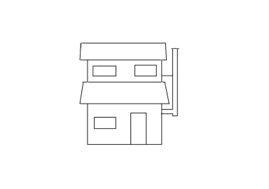

And then this for the outside. Do they make a product to support the chimney so I can go around the roof overhang? This house has a brand new metal roof and I don't want to put any penetrations in it if at all possible. (Obviously not to scale)
Any stove recommendations for this set up? House is a 1500sf two story. New construction, pretty tight with 6" walls and double pane windows.
View attachment 123302 And then this for the outside. Do they make a product to support the chimney so I can go around the roof overhang? This house has a brand new metal roof and I don't want to put any penetrations in it if at all possible. (Obviously not to scale)Link Removed
That will be more costly, uglier, and less ideal functionally. Why build a defect into a new house?

I agree on the aesthetics, but I'm a function over form guy. Can you explain to me why it is functionally not as good? I assume the two 90 degree bends won't help draft, but I'll have quite a bit a pipe to cancel that out (maybe.)
And once I go through the ceiling I have to use class A anyway correct? So, going outside would eliminate building a chase and cutting though 2 ceilings and my new metal roof. I think it might be a wash on cost.

It's going to look like a silver rocket attached to the house. Not that it will need to be 2' taller than the nearest building structure (roof) within a 10ft radius. The cold exterior pipe will have a propensity to build up creosote easier due to the slowing of the draft and exterior exposure. The fittings are more expensive too.
