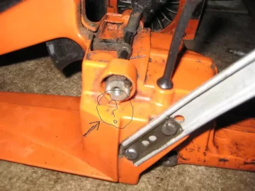

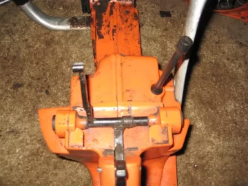

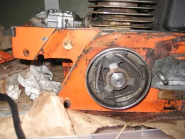

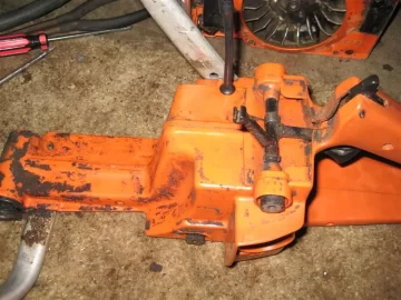

hey guys, i cant seem to find my gas tank breather hole on my husqvarna 61 from the early 80s . .i filled the tank up and it would cut for about 2 minutes then would idle high and lean out.
. i took off the top of the saw to separate it from the gas tank below. i cant find it ! did they even have them back then? i hooked an air compressor to the top of the gas line sticking out of the top of the tank, gave it a couple little taps and the only air coming out was seeping out of the gas cap, but barely . if i would have help the compressed air down it would have blown the tank apart!
i think its supposed to be on the right side just behind where the handelbar attaches.
it should be the same on the 266 268 272 61 and 66 models.
heres some pics....

i would say where you have it mark would be right. Man that thing is old!
older the berry , the sweeter the sawdust !!! going bucking right now to see if i just needed to turn my gas cap 1/8 turn past it stopping, which is at about 11 o'clock on the knob. we shall see.
I was thinking the same thing. I wonder if there isn't a valve that opens when the throttle shaft moves? Try pulling the shaft and looking where it pivots.
My Husky 55 Rancher does the same thing, does anyone know where the vent is on that beast??? I thought that I had bad gas but with fresh gas it does not stay running either. Not trying to hi-jack post, but I have been using my back up 16" craftsman instead since August.
no valve, oh well . i guess the guy i talked to from sweden wasnt lying when he said this saw was the first 61 batch from sweden, according to his father and the serial # .

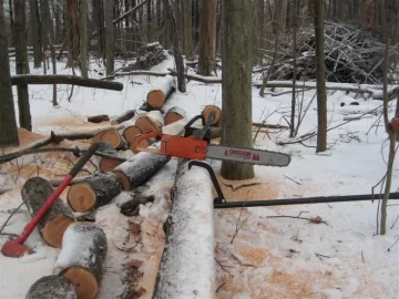

got her up and running... apparently my saw only used the gas cap as a one-way air inlet, so i cleaned it up and off to the races..... a face cord of maple like butter!

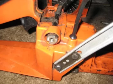

well, you guys scared me so much i got a brand new aftermarket one from an ebay seller for 40$ shipped! fit great and works like a charm (click pic and youll see it) its the new grey style one. 40$ or no arm... lemme think ! :) my lady is an ICU nurse and just had an arborist in the hospital with sawed off thumb from slipping his arm onto the chain. ... when i heard that , well that was it, i got one!
