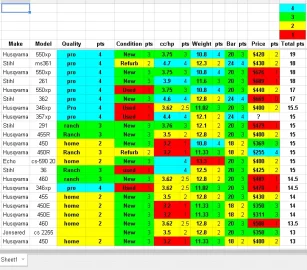

Which saw would you buy?
I will be using my future saw to buck 5 cords of delivered logs to my house, that includes mostly soft but some hardwood. Expected diameter of logs will be will be 24" or less.
After doing lots of research, here is a spreadsheet of all the chainsaws that I am considering.
"pts" stands for points. According to my rating system, the saws getting the most points should be the best deal for me, and are listed at the top.
Based on the saws below and what I need one for, which one would you buy?

I would get the first saw listed (550xp) rather than the third (550xp) since they are identical but the first one costs $206 less. Seriously the 550 sounds like a good saw depending on what you actually have to pay. Is dividing out cc with hp fair? Saw guys chime in, better to have the extra CC for grunt vs max HP? IDK I'm asking.

Anything in blue in the quality column on your spreadsheet there. I don't see a downside to any for your needs. Stihl 36 - is that supposed to be an 036? If so, that's a pro model and should be blue for quality IMO.

good grief .. you are over thinking this ... tells us your budget and if it's gotta be new?
First, delete everything in the "home" category.
Second: It seems like you already have a rating system, so I see six saws in the 17 - 19pts range. I just don't think you can wrong with the husky or Stihl pro models (unless you buy a lemon of a used saw).
Buy the one in that range that is either the cheapest (if budget is a concern) or the most powerful (assuming you can afford every saw on that list).

PS - I like how you think in rating these saws, neat idea.
