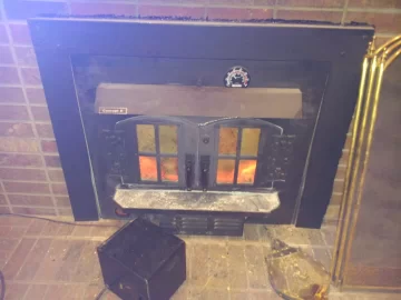

About 2 years ago I purchased a Cemi Concept II. It is awesome, last year we counted the furnace turning on about 10 times, we live in CO. We use it as our main source of heat for 2100 sq ft. The mica needs replaced, another fan added and a custom collar made so that we can line the chimney. We have been running it unlined and pull the stove out to sweep the chimney. The black box in front of it in the picture is a fan from an old grate blower system to help move the air better. The cost of the stove and the repairs will have me in to the insert for about $500.00. I researched this insert before purchase and found several reviews that helped in my decision. All of our wood is free and we only use good wood. We cut and split our own wood and season for at least 10 months in a metal shed. We do not burn wet wood.

  • [Hearth.com] Which decision and info needed
