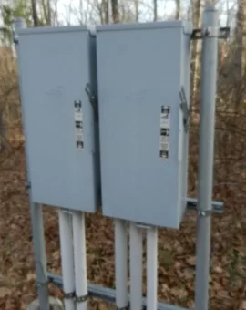

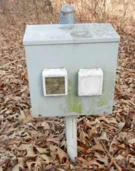

My setup is a little different. Because the switching and pressure tank for the well is in my shop, I have two circuits that run from the meter box - one to the house and one to the shop. We are a 100 % electric household, and this will run everything including the two heat pumps, electric water heater, oven, even the dryer. But during heating season I am running the Jotul F500 anyway.
I have this Generac Guardian generator
which plugs into these outlets
Which is switched and isolated from the utility lines here
The generator is run every quarter for a couple of hours. The electric cord you see at the bottom of the top photo is the lead from the battery tender. This has served us well through several power outages of half a day to two weeks. Fuel consumption seems reasonable, but I shut it off overnight (and put it back in the basement. You never know...). It is too loud to be used in a neighborhood, in my opinion.
