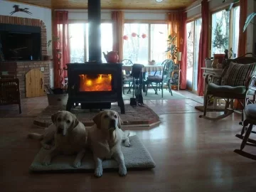

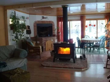

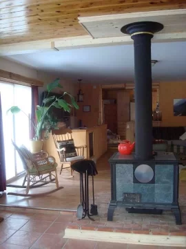

I have a similar layout. You can see the sunroom doorwalls on the south of the house. The photo from behind shows the kitchen and foyer to the north. I have a second floor that heat has to rise to. It is usually 5-6 dgrees cooler upstairs. The EQ has done everything I have asked it to. I am glad I did not go smaller. I have yet to load it to full capacity. Maybe I will when we hit sub-arctic temps. Good luck with your install.
Wow , thats a beautiful room. Nice install. For the OP, I would have someone measure the tile both ways. You can get an 8" flex liner ovalized to 6x10 more or less, with an oval tee and round take off in the fireplace that would plug into the back of an Equinox. Thats a hell of a good stove, for your size area I would make it work. Make any provisions needed to have enough stove sticking out to get the radiant heat benifits and to use the side door. Where in Southern NY?
Wow, that is a beautiful room. I love the dogs. I have cats and a dog, so with the Hearthstone, I don't have to worry about them getting burned if they get too close. I have a Four Seasons sun room on one end and my fireplace is about 25 feet away on the other side. I can't use the Mansfield because of the top flue opening. I agree that the Heritage is too small. The damper opening in my fireplace is 6" X 41" rectangular then opens into a large space going into a round opening. I couldn't get in far enough to measure the other opening, but it looks to be at least 8". I'm in Putnam County, NY. Is there somewhere on-line that I could look at the oval pipe? Thanks

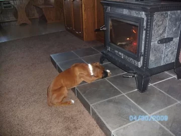

  • [Hearth.com] WHICH SIZE HEARTHSTONE?

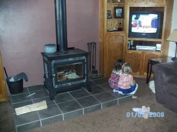

I love the pictures. What is under the floor? Did you have to add extra support? My hearth is only 7-8 feet from the front door. Will the floor need support for the stove to be carried in? The stone slab in front of the fireplace is on the block foundation in the basement, but it is old, probably built in 1948. I have to confess, this makes me very nervous. Another question. If you use an oval adapter to reduce the stove pipe to 5.5" to come through the damper and then adapt it back to 8" past the damper, will that affect the stove performance? Will creosote gather in the reduced area? Another question. How can you clean the pipe once the stove is installed? There will be no moving the stove to access the pipe from inside the fireplace. I can't use rigid smooth liner because my chimney has a slight bend in it going up. I actually called my chimney cleaner and his wife told me he doesn't like wood stoves in a fireplace, because of the difficulty cleaning. And, finally, if I could make the Mansfield work, do you think it will do the job? It weighs less at 575 pounds giving off 80,000 btu's, which supposedly heats 2500 sq. ft. vs the Heritage at 1900 sq. ft. Sorry for so many questions, but I'm exploring all my options.

You did notice that this is the heritage right? It looks pretty much just like the EQ but about half sized and only 500#. To that 500#s you need to add the tile and mortar weight (at least 50#), the 2 layers of durock (200#) and then you should consider the max wood load weight which is like 50# and then if some fat chick wants to stand next to the stove and warm her rolls maybe another 250.
I did add extra support. It's hard to notice but the stove sits where a fireplace once sat. My old style construction, 1962, was big beams on 5 foot centers and then 1.5" tongue and groove decking running perpendicular to that. The stove would set between two of the beams so I built a 2x8 frame and supported it against the floor decking with 2 new beams and concrete supports. The cool adjustable pier pads. Click on my OAK link in my sig to see the supports from under the stove. I probably didn't have to do it but it was cheap and I feel better.
The raised hearth is made of steel studs and was done to provide the required R-value for the hearth. We actually like the raised hearth.
