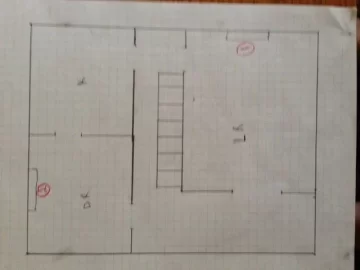

I live in southern Ohio in an old farmhouse. Currently I have electric baseboards. These are not keeping the house warm and the electric bill is crazy. I am considering adding a stove for both comfort as well as saving on the electric bill. I would love it to provide the bulk of the heat.
The house is two floors, each 1200 sf. The house is poorly insulated and drafty, with ten foot ceilings. I am trying to tighten up the house but there is only so much I can do.
First, where would you put the stove. Choice one is where we spend most of our time, but my wife doesn't really want a stove in the living room. Will choice two distribute enough heat? I will probably put in some kind of vents or registers to help get heat to the upstairs. Both levels have the exact floor plan.
Finally, I prefer something simple. I am impressed by the Blaze King's but am worried it will take too much attention. My wife wants something pretty with a nice window. Thanks

Option 1 will give you more even heating and a nice fire show that is better than a TV. Option 2 with a small fan in the floor, in one of the doorways, would create a convection loop and work. If you don't want a BK, check out Woodstock, the Progress or the Ideal Steel. Neither are a simple stove, both are very easy to operate and very efficient. Insulate what you can. How well is the attic insulated? Its usually the best/easiest bang for your buck.
The room you usually spend the most time in would be preferable but I guess the dining room will also do if necessary. Are there already existing fireplaces? Dimensions and pics would be helpful. What budget do you have in mind? Any idea what style your wife thinks is "pretty"?

Is there a fireplace in location 1? That clearly looks like the best for heating the largest area. If you agree this may take some convincing. Post a picture of that location and let's visualize what a good looking stove would look like there.

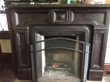

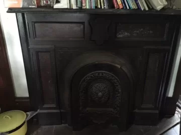

Thanks for the quick replys. The house is all brick, the outside walls are three wyth with an air gap between the second and third course, the interior walls are two wyth. All are covered with plaster. I've installed storms and am in the process of more caulking. I put insulation in the attic. All the rooms have fireplaces, although location two had the chimney taken down below the roofline a couple of years ago. For what it's worth, there is also a lower level that I'd love to put the stove in, but I' afraid the heat wouldn't circulate well since it has a concrete floor. (Same floor plan as other levels, but with 71/2' ceilings). Is that true? Here are pics of the two fireplaces

Thanks for the pics; which is the one in the living room? At first look the fireplaces don't seem to be suitable for an insert but putting a stove in front may work, especially with the first one. How high are they measured from the hearth and how deep is the hearth? What are the mantels made of? The first one does not look like it is wood. If location 1 still has a full chimney that you just need to drop a liner down there that will be much easier and save you several hundred.
I would skip the idea of a basement stove. Putting a stove on concrete and trying to heat 3600 sqft will be next to impossible. For that location you will need a wood furnace or boiler. Later you may add another stove there but to solely heat that floor.

All the fireplaces were coal burning originally but two were converted to wood. The first pic is the living room. We want a freestanding stove. I'll check out the suggestions. The Jotul also caught my eye. I'm having a tough time deciding if a cat is for me. Any other cat stoves other than Blaze King? Thank you for all the help. Edit to add I checked out Woodstock Progress Hybrid. I really like it. As I start more research, anything I should keep in mind?
Since your fireplaces do not look that large to accommodate a top-venting stove you will need a rear-venting one. BlazeKing does not offer one but the already mentioned Woodstock Progress Hybrid or the Ideal Steel would work. In non-cat the other large options are: Jotul F600 and F55, Hearthstone Manchester, Quadrafire Explorer 3 (new model, just came out) and Isle Royale (has been phased out but some dealers may still have one).
What you should do first is to measure the height of the fireplace opening. That will determine which stove fits; look for the height of the flue outlet. The Progress Hybrid with the short leg kit has the lowest requirement at 26"; the others go from there. That requirement may already reduce your choices. Then look at clearances, hearth requirement etc. to decide which models would work.
