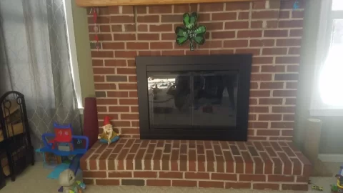

Can you post a pic of what your fireplace looks like - WITH dimensions?

How big a space are you trying to heat? What's the layout? Fireplace size? H, W, Depth, any taper?? Pics and specifics are important to make a good recommendation.

I got some measurements in inches. Let me know if I should be taking other measurements.
Front opening width: 36
Front opening height: 29
Rear wall width: 24
Depth: 24
The house is 3800 square feet but the areas open to the fireplace are probably 450-500 square feet. I'd love to be able to heat that area nicely and I may add some fans to draw some of the heat into other rooms if the stove is powerful enough. My husband definitely wants a contemporary look. I'm not certain I'm thinking of the right thing when you say flush insert but if I am I don't think it has to be. I original thought that looked nicer but I saw references that they may not be as efficient and efficiency is my bigger concern now. We do have other dealers in the area. There is a Lopi dealer nearby and I know others came up in my search but I haven't looked at what brands they offer yet. I really didn't get past looking at Napoleon and Lopi yet.

Is your mantel wood? Check the distance required from stove top to mantel on any model you consider.
