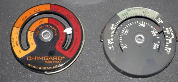

Hi,
Here are two thermometers - reading around 150 degrees apart......on top of my stove.
I was sold the one that says "use on stovepipe" by a local shop, who said it's accurate on stove tops - BUT, the other generic one I bought online, consistently reads a lot lower...........any opinions? Thanks!

If you switch places do they give the same difference (i.e. is it location dependent)?
Yes, I have moved them multiple times, it's always the same with the one reading higher. Not sure which one is accurate! For now I just average it out! ;)

Flue probes work pretty much the same as those magnetic ones and can easily be just as far off.
If someone actually wants to check one put it in your oven. Assuming your oven thermostat is known to be correct.
There is absolutely nothing wrong with magnetic thermometers for single wall pipe or stove tops.

I have a Condar like yours that's probably 30 years old, on the stove top it checks the same as my IR gun. my money is on the Condar.
I just had a new Condar FlueGard be off over 100 degrees (lower) than it's replacement. No questions asked though so good on them for the replacement.
Those type of thermometers are good for a rough estimate on temps, not actual. Just get a $30 IR gun if you want accurate stove top temps.
Those IR guns are not very accurate either. I've got three of them and the stt can vary as much as 100 deg. Like most others they just give you a rough idea.
