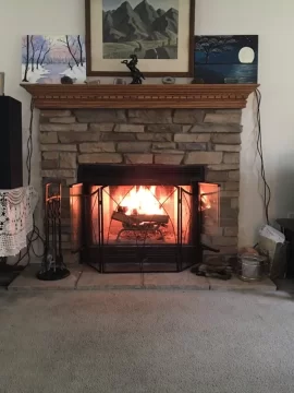

The fireplace is a Lennox bc 42 and it is about 8 years old. I don't have a masonry chimney. Is a liner costly to replace? Please advise. I will post exterior photos later this week too.

In that case you need a liner because the chimney on that fireplace for one is way to large for a modern stove and it is also not rated for a high enough temperature. And I would recommend an insulated liner no matter what the situation. In fact it is almost always required by code.

I see now that it's a builders box/factory built fireplace and not a masonry chimney.

The Lennox BC42 should have a Security FTF8 chimney system. This is triple wall. Why would insulation be required for the liner in this case? Doesn't the pipe design and size create the required barrier to combustibles based on its design and that it is installed with 2" clearances?
Yes but if the ul listing of that liner calls for insulation then insulation is required by code. I saw that the installers they will be using use homesaver liners and I know that their listing requires it. Also a triple wall chimney is air cooled so it will not do much to maintain temperature in the liner so you want it insulated for performance reasons as well.
I will also say that many prefab fireplace chimneys where not installed with proper clearance so before doing anything that should be confirmed.
