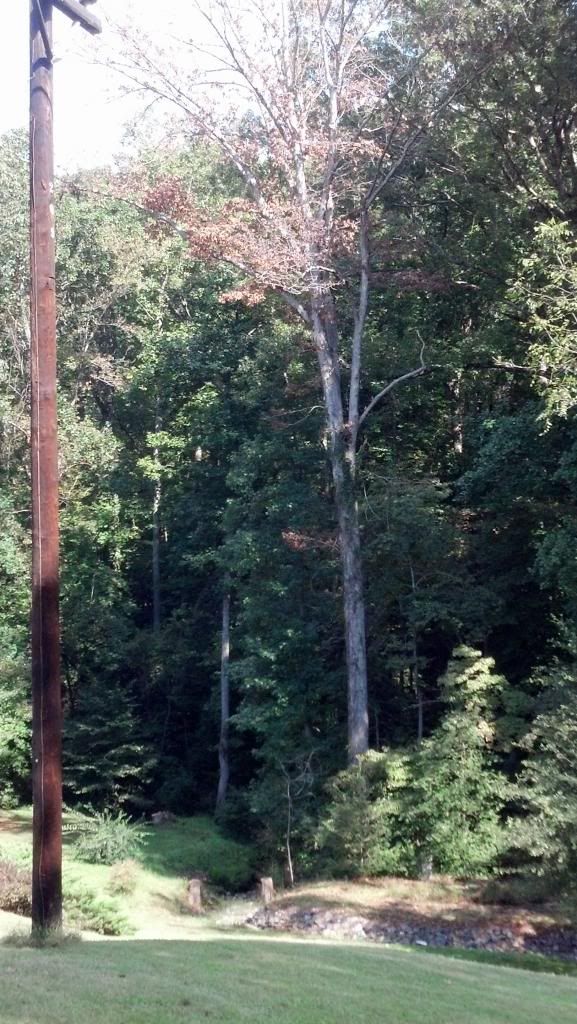

my neighbor told me a while back i could use his splitter any time i wanted, and i split everything i had by hand that i could, so i decided to take him up on his offer. when i walked down to his house, he pointed out a white oak that had just recently died and told me he was having it cut down and i could have all the wood. he said he would haul it to my house with his front end loader. the tree is big... around 100 feet tall, and looks to be somewhere in the 24" to 26" range down low and is mostly straight. with the splitter he said he never uses it, and didn't say he was giving it to me, but told me i could just keep it at my house. no clue of the details of it other than it has a northern hydraulics sticker with a serial number, and date of 12-87. it has a tecumseh engine with no details on it, but it went through some pretty big red oak, and the nasty stuff in the picture of the splitter. we'll see who all can identify the wood that's below the splitter.

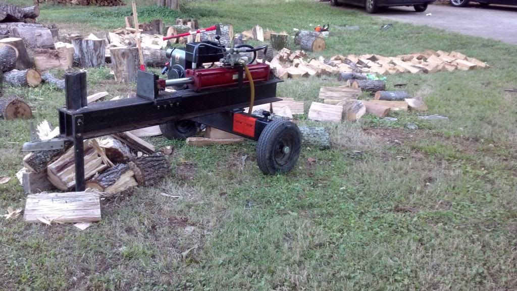

Looks like a well built splitter.....Home made?
[Hearth.com] white oak and splitter
I have the same splitter, picked it up 3 months ago. Has the indian motor, unknown hp & tonnage but mine kicks some major butt, splits everything & anything. I guess 5-8hp motor & 27-33 or more tons. Hey could you post the serial number, mines gone & i'd like to find more info on it, great splitter. Yes, try to buy it. I paid $400 for mine, this one looks cleaner.......
it seems very well built, but not homemade.
this one is pristine, i almost feel bad about using it, and will have it out in the driveway after using it like detailing a car, lol. the serial number was very basic, like a 5-6 digit numeric only one, but, i'll see what we can come up with.

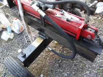

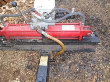

I see yours still has the original clear plastic oil return line. Be prepared for that thing to crack or let loose. Mine did. Easy enough to replace with a standard black hydraulic hose from TSC.
You can see in the two pics I posted, the one pic shows the old clear plastic hose(well not so clear anymore) and the new hose from TSC.
The tank vent on mine was also plastic, and I broke it. That I replaced with some piping pcs and drilled vent holes in the cap. I also put a screen and the foam filter back in the new home made cap.
