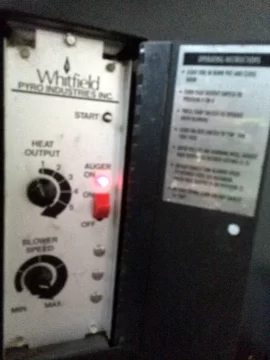

The panel has knobs. Here's a pic of it.
  • [Hearth.com] Whitfield stand-alone: unburned pellets blocking chute when on HIGH
Ok. you have the older style board, I didn't realize it didn't have the trim pots like the 'newer' board has. Clean the stove top to bottom, same for your flue pipe. Adjust damper. Lastly, try different pellets.

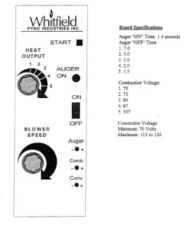

What is behind those silver colored items on the control panel? Maybe trim controls?
Yes, under the three silver colored items there is access to trimpots on the circuit board. The auger trim pot is the one at the top. I believe the silver colored 'button' would have to be prised off to get to the trimmer.
But before altering the setting of the trimmer, you'll have to check carefully the actual timing of your auger when it is operating... does it follow the timing chart shown on the illustration below?
in order to measure this, you'll need a clock with a clear indication of seconds, while you count the seconds of the auger on/off action.
Illustration of control panel front and auger timing chart etc.

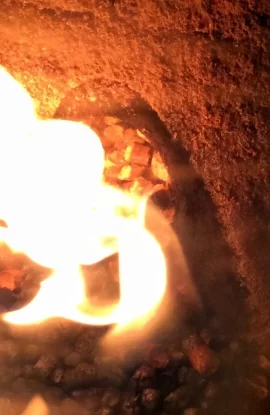

Hard to see, but I've posted a picture here of what it looks like. There is a stack of semi-burned pellets. The flame is big and yellow. After a bit, I opened the door carefully (after the fire had died way down), and unblocked the chute, and it's going fine again. Turned the auger back on, but this will have to be tended to, and not let run when we are not here at this point. Which will stink for coming back home to a cold house. Better than coming home to a fire!
Once he's better, we will do a very thorough cleaning and see if we can't figure this out.
