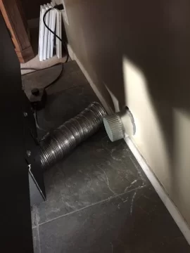

Thanks guys. My stove is on the main floor. Chimney is 15ft. On really cold days when I get her burning you can hear it chugging good. This is usually in the morning. Midday always the fire gets lazy. Heat drops. I took out the knock out part for the OAK last nite and blocked the air in the front with the metal plate that came with it. Now there's know turning back time to punch hole in wall. It's nice straight shot back .

Pictures of my OAK

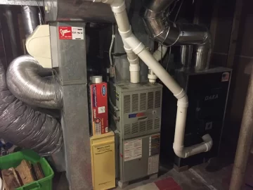

I added this one for my wood furnace. I tapped into the supple for my propane furnace and it drops right in front of the intake. If I use the propane then I take off a 90 and cap it
That's interesting. If the inlet pipe is not connected directly to the wood furnace why would air travel along the inlet pipe instead of just entering from the room directly to the furnace?
Have you checked (with smoke or something else) to see outside air gets to the furnace?
It balances the neg pressure in the room from the pull of the furnace and the baro damper. If you look at where it connects on top of the furnace, it just stops right on top and still has the vents all around it, so its not a sealed system by any means for the propane side.
With a nice hot fire going, you can out your hand in front of the intake and feel a nice cool breeze coming in. Outside you can feel quite a bit of pull too. Works great, no puffs of smoke anymore either.
