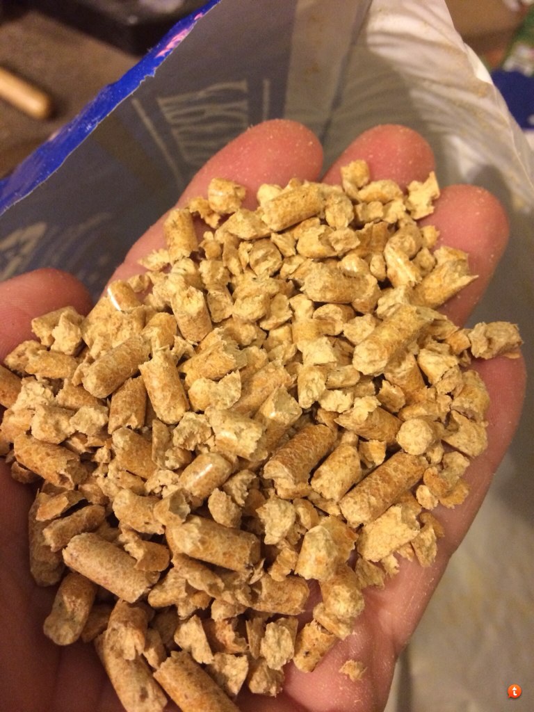

I bought some freedom fuel today from TSC as well. The bags where still warm even. I just dumped a bag into the hopper and the pellets are very tiny compared to a month ago when I got some.
Are the pellet plants rushing the pellet making process somehow to get the pellets out I wonder..

The parent company of Freedom Fuel also owns Equine Pine horse bedding. The half ton of Freedom Fuel I just bought looks to be a mix of light colored pine bedding and darker pellets. One bags looks like all pine bedding.
They are shipping whatever they can at this point. Some of the bags are not even fully heat sealed!
