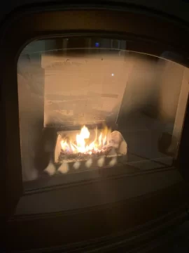

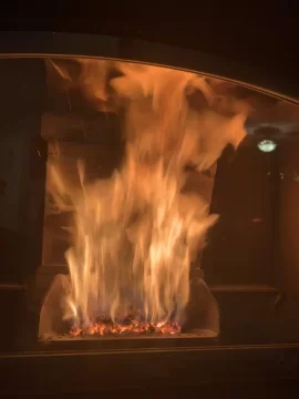

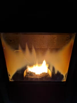

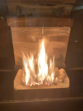

I attached a few photos of a start up after a cleaning. The last photo is the glass after one hour. It gets darker and dirtier from there in the same pattern.

That does seem to be abnormally dirty to me, but I run P-series Harmans so am unsure how big your ash pan is (mine go weeks between cleanings even with the worst pellets). I read somewhere that someone else is getting interesting ash out of the Hamers this year, but I wouldn't think it would be that bad.
My P43 runs with a clean glass for weeks, my P61a glass gets dirty, but in a pattern and certainly isn't massively dirty after a couple of days (using same pellets). Your picture doesn't look all that bad - but for an hour of running is probably worse than it should be.
The first picture looks like a great flame but I'm not liking the second picture's flame. Try removing your OAK from the back of the stove and see if there is any change. If so, there could be an obstruction (check inside for clear plastic pieces from the packaging materials - been there). Also, if the OAK flex pipe is not 3", and going around the outside of the pipe on the stove inlet, then it may not be getting the air it needs. If removing the OAK flex pipe doesn't change the characteristics of the fire, then check the air inlet path for the stove for foreign materials.
Last thought, if it has been very humid in your area, that can affect the ashiness of pellets - at least that is my experience. Nothing you can do about that though except wait until it gets cold and dry.
I'm sure others will be along with suggestions.

does the stove spend alot of time on low burn, My Allure burns mostly on a low burn and my glass gets dirty quickly also but when it does get cold enough for the stove to work a little bit the glass stays clean longer and I get less ash. The grinding noise does not sound normal, my Allure has never made any grinding noise. I would try a different pellet and see what your results are.
My Allure glass after 13 hrs low burn

What stage of burn was that second shot taken at ? The only time I get a flame like that in my P61 is from an overload of fuel on start up because the stove needs cleaning, more specifically, the ash needs to be removed from below the igniter.
I have a new Harman this year and I was having the same issue with the dirty flame. What I realized was that the vent pipe outside was getting clogged with ash. Due to a lot of humidity and rain, the mesh screen was building up with ash and therefore getting clogged which was causing the stove to get limited air. Look outside and see if this is happening to you. I took it off and cleaned it and vacuumed it out. Now at least once a week I go outside with a dustpan brush, brush the screen clean and tap the bottom of the pipe to let the ash blow out. It is likely due to the moisture plus a cheaper pellet burn.
Good call. I did check the vent pipe and it's all clean. It was only installed a few weeks ago so I would have been surprised to see anything in there. I took the pipe off the wall outside and it was mostly clean.
Just like you mentioned it was a fuel overload on start up. We do at times have the flame rolling at the top of the fire box. Luckily I think that was just a bad pic as I almost always have a white hot flame and never really see any lazy orange flames at all except for when the stove is shutting off.
