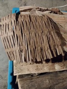

Pack firebox. Plop a chunk of this on top. Touch a match to it and away we go.

What is that? Shredded up cardboard? Looks like it would work really well.

It's a cushioning material found in parcels received... a non-corrugated cardboard mesh. While I'm too tight to buy this stuff, it's easy enough to save it throughout the year.

You need to be cautious when you use something that burns extremely fast as a fire starter. Many chimney fires happen on Christmas day when uninformed wood burners decide to light a fire in their mostly unused fireplace and then decide to dispose of their Christmas presents wrapping paper by burning it in the fireplace. It incinerates in an instant, shooting up the flue, snagging on some creosote and then the entire chimney is on fire! Using a fast burning paper product like in your photo might react in a similar fashion. Also, during this time of year some roofs might still have a lot of dry leaves sitting on them if the owners haven't cleared them from the roof (if there are a lot of big trees around like on our property). LIght weight paper materials that send large pieces up the flue can escape the chimney, even with a screen on the cap, and even a small ember can quickly ignite a pile of dry leaves.
