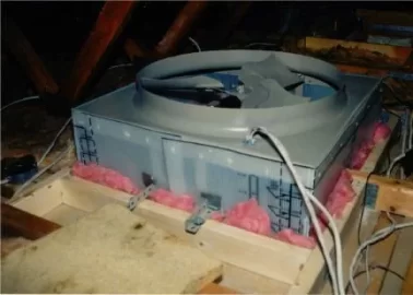

Nice neat job down below, now get some staples in that romex and neaten it up in the attic. Seriously, those loose wires can be a hazard and are not to code.
HAHA I knew I would get called on that. I measures and left enough slack to properly attach the romex in place. I also have to straighten up the insulation. But it was about 11:30pm when I left the attic) The house was built in the early 50's (not knob and tube, not sure what the black stuff is called). so 90% of the wires are laying across the joists, under insulation, etc.... rewiring isnt an option, so it is what it is, but for the newly installed items I always do my best to insure they are done right.
I wasnt at all happy with the electrical aspect to the fan, the "junction box" that all the wires were to be fit into was about 2"x2"x2"It was too tight for easy work. But was able to get wire nuts on and electrical taped the nuts on and everything in place.
Thanks for calling me on that! Seriously, its important, but i have every intention of doing that tomorrow.
Thanks
Rick
black stuff is a early version of romex. back then ground wire was a option. some had it, some did not. next time your up there remove the tape. if you did the wirenuts right there is no need for tape. but the big reason for removing the tape is between the heat in the attic and the heat the motor makes the glue from the tape starts to liquify and gets into the splice and acts like a insulator. and soon enough the splice will fail. seen it happen alot in attics.

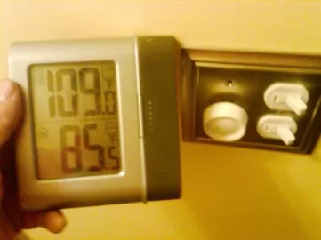

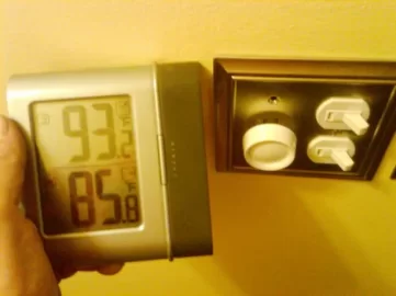

Hello maverick06
I just did some testing on my whole house fan.
It is 88 degrees F outside in shade and 94 Degrees F in the Sun and the attic is 109.0 degrees F.
After running the Fan on High for approx 3 mins the temp in the attic went down to 93.2 Degrees F
It is 85 Degrees inside!
How is your fan working these days??

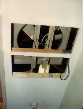

Aren't the big ceiling fans just great? We love ours.
If you didn't get one of those self- adjusting louver covers with that fan, may I suggest that 1/2in grid wire cloth, spray painted white with Rustoleum, would make a very attractive ceiling fan cover without restricting the airflow much. You'd notice the fan a lot less, that way.
Thanks, that is a good suggestion Cluttermagnet
I do have the self adjusting louvres, just not in those pics. :-)
They do move alot of air!
